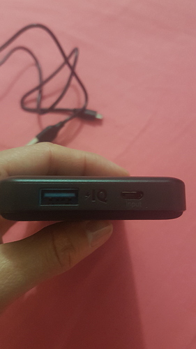

Awesome review.
My only question is it usb c or micro usb for charging th actual bank? Other than that great review and definitely something I would consider purchasing.
They do look a lot nicer!
What does it look like?
Don’t recall 3.0 micro very well.
3.0 micro was used on Samsung Galaxy S5…I only know this because i had to switch from my Moto X Pure to the S5
Isn’t 3.0 micro what they use for the Portable Western Digital drives nowadays?
3.0 micro is used on a number of USB 3.0 external hard drives and DVD / Bluray drives, all at the device end.
